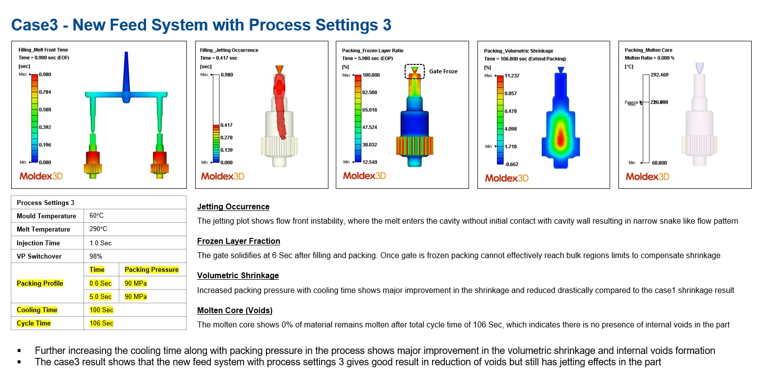

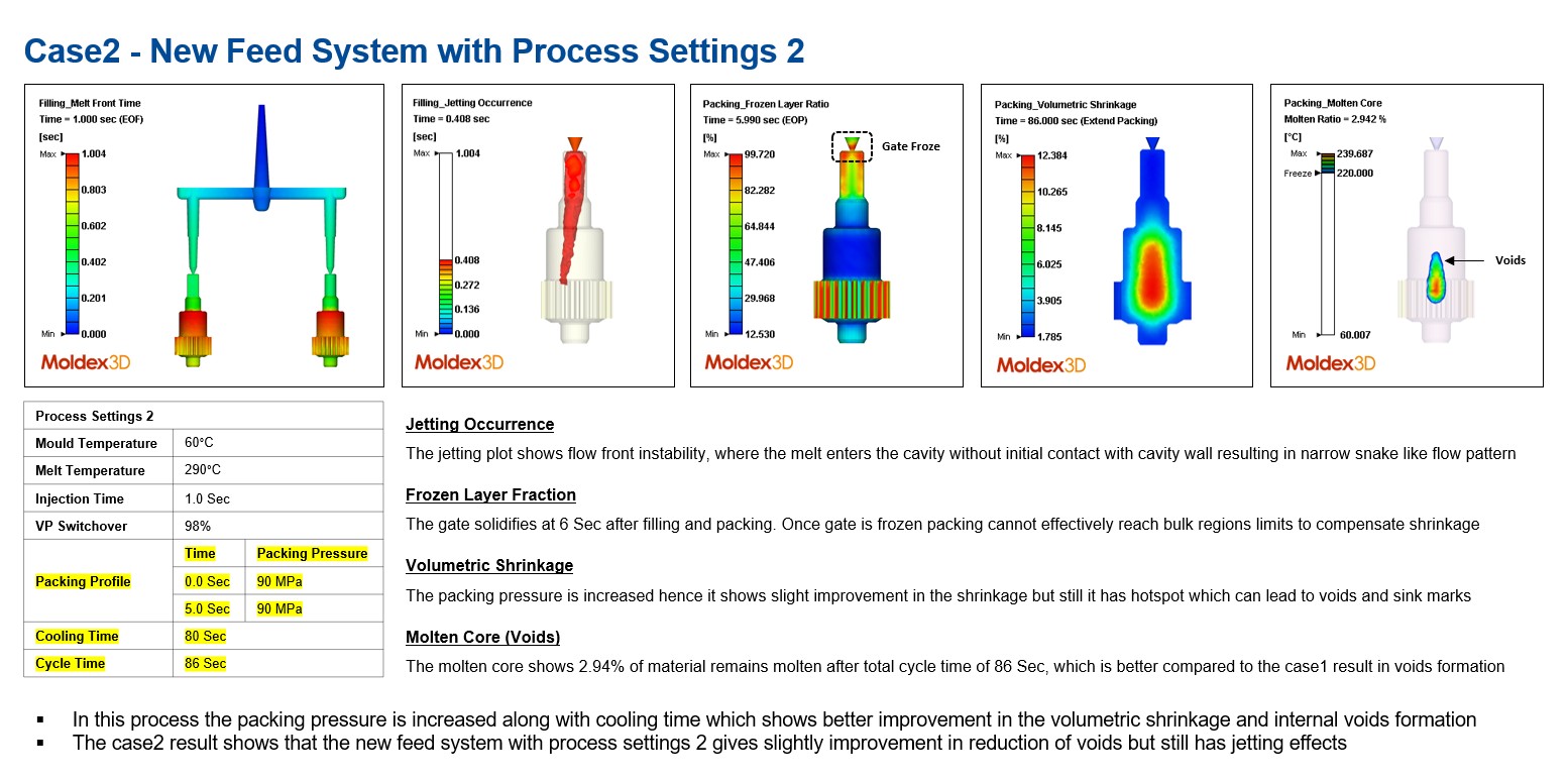

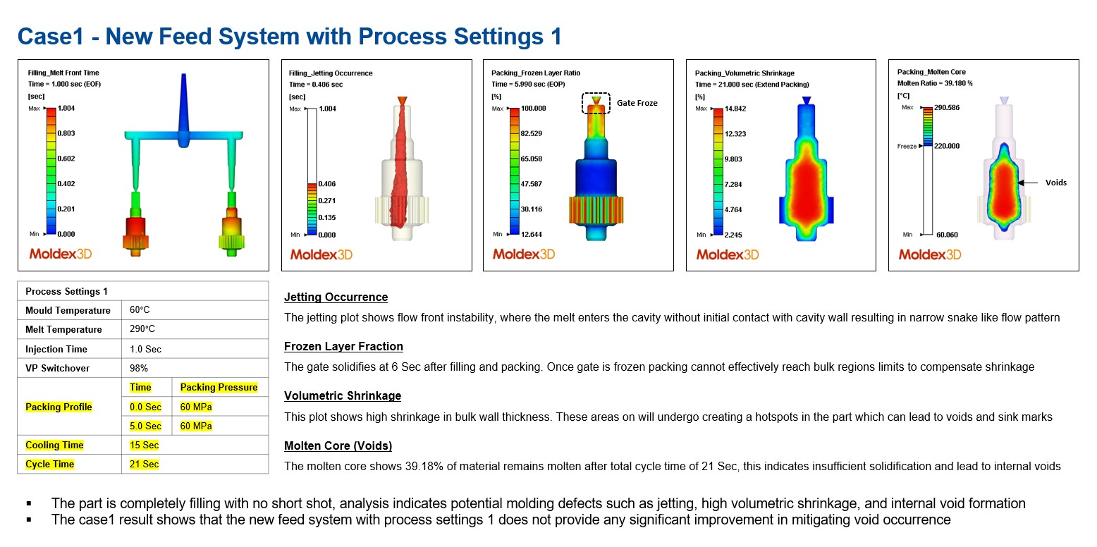

I have carried out three case studies for this part:
Case 1: Ideal process settings
Case 2: Packing pressure increased with higher cooling time
Case 3: Further increase in cooling time
The plots for all three cases are shown below. Kindly suggest whether the plotting and the statements provided to explain the voids are scientifically correct, or if I need to modify the explanation to represent the void formation and reduction more clearly.
Do Molten Core result can be use to predict the internal voids ?Case1 Plot
Do Molten Core result can be use to predict the internal voids ?Case2 Plot
Do Molten Core result can be use to predict the internal voids ?Case3 Plot
