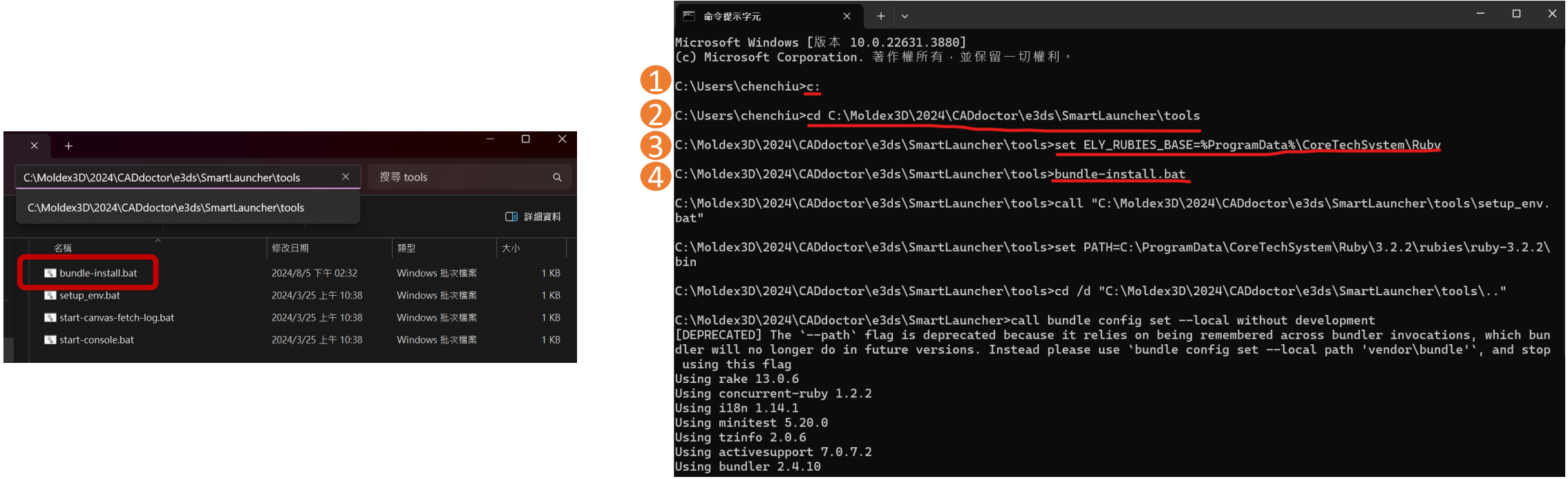

1. For CADdoctor 2024 R2 users -> launch bundle_install.bat
- Run cmd as Administrator and do the following four steps
– Make sure the folder goes to installation folder (Default is C) by typing in C:
– Point the folder to CADdoctor Tool by typing in cd C:\Moldex3D\2024\CADdoctor\e3ds\SmartLauncher\tools
– Type in set ELY_RUBIES_BASE=%ProgramData%\CoreTechSystem\Ruby
– Type in bundle-install.bat

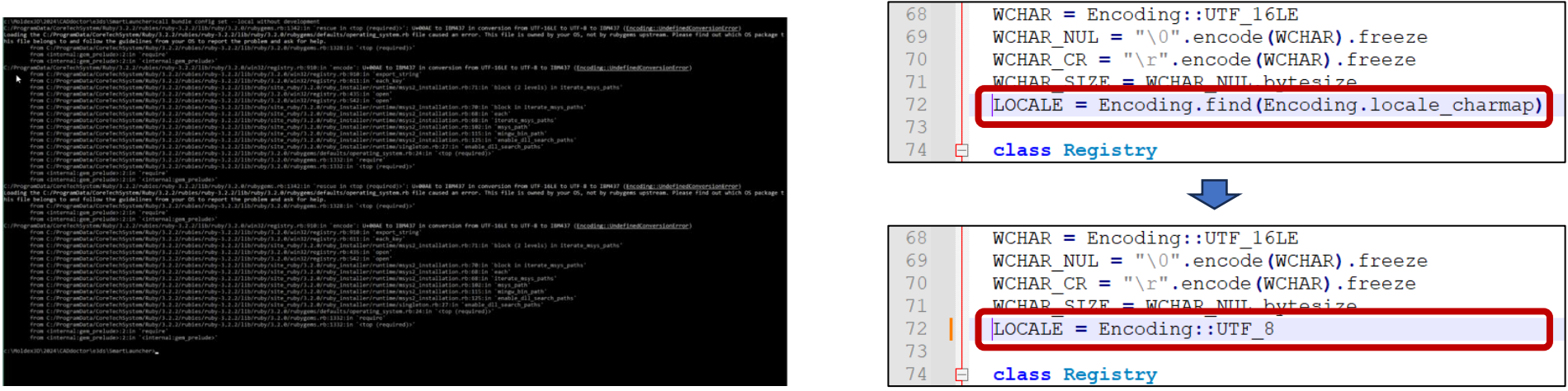

- If the cmd returns the following information indicating the installation failed, you can try the following steps to see if they resolve the issue.
– Open in text editor\ and modify ruby registry.rb file
1. C:/ProgramData/CoreTechSystem/Ruby/2.7.6/rubies/ruby-2.7.6/lib/ruby/2.7.0/win32/registry.rb
By editing line 72 of the above file as follows, it may be possible to avoid the issue.
2. Before) LOCALE = Encoding.find(Encoding.locale_charmap)
After) LOCALE = Encoding::UTF_8
– Redo the progress in the last page
