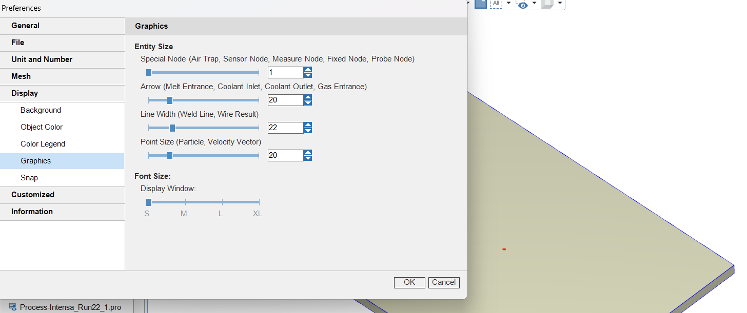

Is there an option to control the size of display items? For example, the measuring node size on screen in Moldex3D? Sometimes, the measuring point size appears very large and hides visibility to the part surface, such as sink mark positions. If I place a measuring node on a sink mark, the red color area is covered by the large measuring point ball.

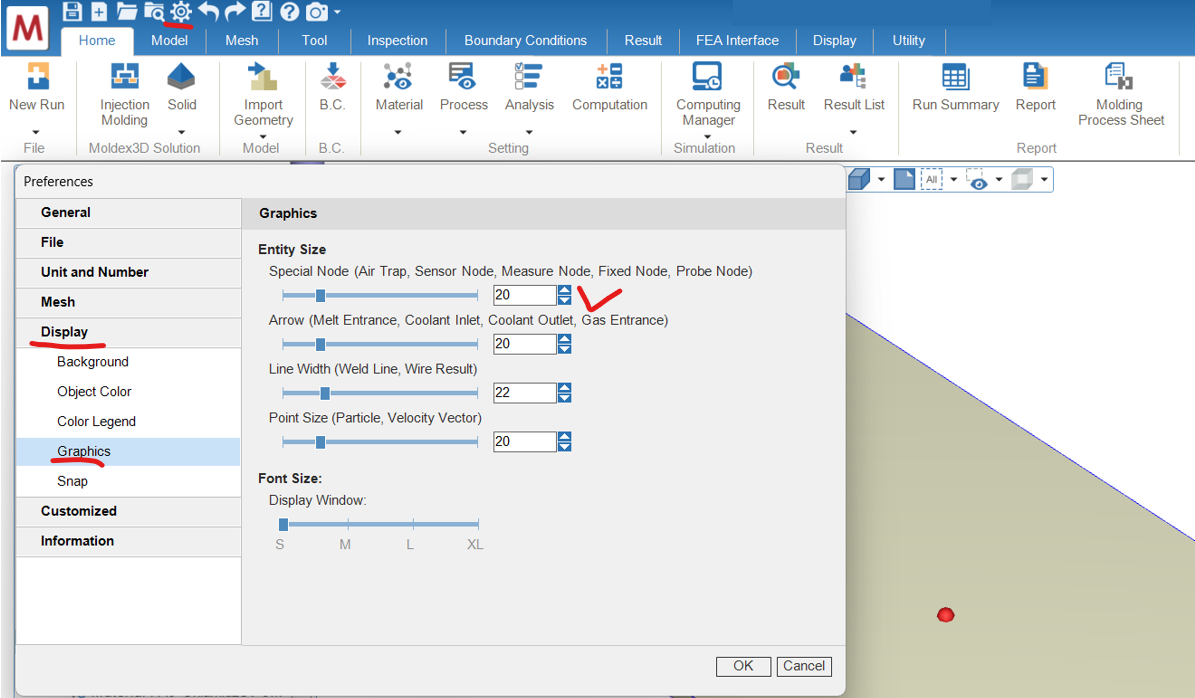

Yes, you can adjust the size of the display items in the “Preference” settings.
Users could find the “Display” section and go for “Graphics”.
For example, the size of probe could be control by the “Special Node”.
