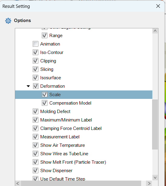

As far as I knew, the auto report can generate the deformation picture as below command:
#Image_Result_Warpage_TotalDisplacement_Deformation
But this is only creating the deformation result with scale 100%, what if we would like to have 2 times or 10 times result, how could we write the command?
Thanks.
Since there are too many result options, the command will be used to output an item, and the attribute will be set based on the selected result option.
You could try using “Save Result Status”
It could save the result with the selected options, including Scale factor.

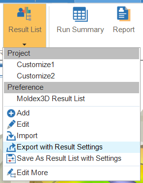

The other method is to save a customized result, where you can keep the original result and the customized result options can also be edited.
In addition, you don’t have to set up the result options every time. If you have a preferred result setting, you can save it as Result List and import it into another project.
