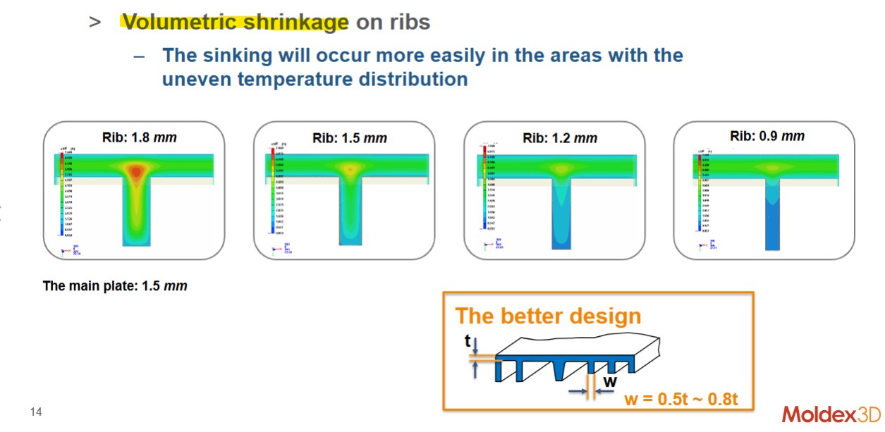

And we usually educate uers to find high volumetric shrinkage region for sink mark and inner void.
I suggest you to take both molten core result and volumetric shrinakge as reference to detect inner void.
