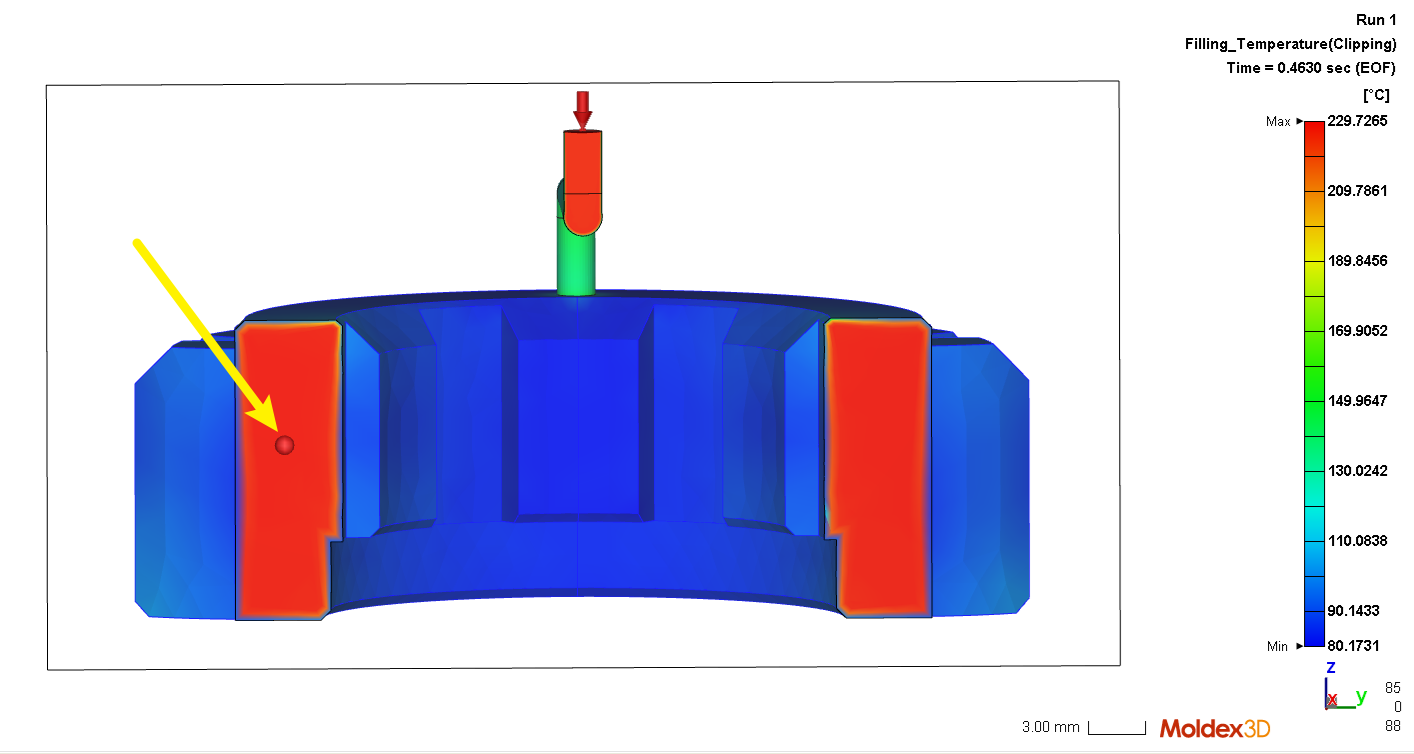

I would like to add a probe in the inner part of cavity to check the results, eg. temperature, pressure …etc, like in the below image. But my probe always appears on the suface mesh.
Can I add a probe in the inner cavity area?

Yes, you can do that! To add a probe inside the cavity, you have to first deactivate the ‘snap’ tool (click on it so it turns grey)
RE: Can I add a probe in the inner cavity area?
Then you will be able to add a probe inside the part on the clipping plane you specified.
